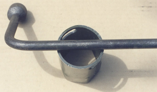

Lug Wrench
Lug Wrench Willys kit: This tool is 10 ¼ inches long and 5 ½ inches wide. The tool is painted flat OD green over a red primer. The tool is stamped on the handle WO A-348.
Lug Wrench Ford kit: This tool is 9 ½ inches long and 5 ¼ inches wide. Tool is well used and there is no sign of any original finish remaining. The tool is stamped on the handle "Ford MH in a circle".
Other Varieties (which may or may not be correct for the jeep): Another variety is 9 ½ inches long and 5 ¼ inches wide. No original paint, if there was any, remains. The tool is stamped "M in a diamond" 41-W-3987-55-25/32. This size differs from the 49/64 listed in the manuals.
