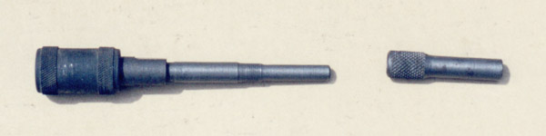

Grease Gun Adapter
Style 1 - Used until early 1944: Alemite Model 5585. No other information available at this time. This grease gun was provided with a lubricating end made to fit a Zerk style of grease fitting. The Adapter itself is 6 inches long and this particular one is finished with a black matte parkerized type of finish. I have seen photos of others that appear to be cadmium plated. The rear of the adapter has a Zerk fitting which attached to the grease gun. In addition to providing an extended reach the adapter provided for two functions. The adapter allowed the grease gun to be used on the earlier style of grease fitting. This part of the adapter could be removed leaving a 4 inches nipple that could be used when greasing the front steering universal joints.

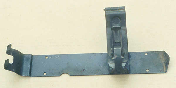

Grease Gun Bracket

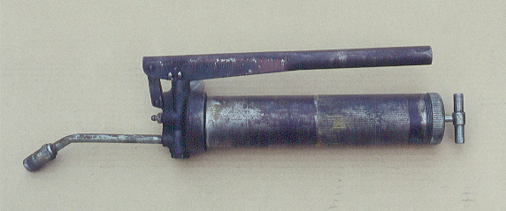

Style 2 - Used after April 1944: This style used a special bracket mounted on the left side under the hood. The shape of the bracket is fairly distinctive and can not be confused with any other bracket. There are four holes in the bracket for mounting screws. These holes are 8 inches by 1 ½ inches apart. The correct grease gun fits in the bracket perfectly. Look at the photo carefully and you will be able to note several identifying characteristics. The markings on this particular grease gun read:
On the body:
ALEMITE LEVER GUN
REG US PAT OFF
MODEL 6593
PATD RL 20.852
016 809 OTHERS PEND
STEWART-WARNER CORP 303361
ALEMITE DIVISION
MADE IN CHICAGO U.S.A.
On the Lever:
LEVER MUST BE OUT
WHEN LOADING GUN
ALEMITE

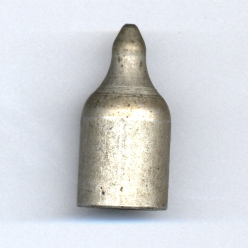

Grease Gun Adapter The Adapter used on lever style grease guns: The adapter for the lever style did not need to be as complex as did the earlier style. The later style grease gun already had a longer reach. The lubricating end to fit Zerk fittings could be unscrewed and this adapter screwed on. The threads used on the different pieces of lubricating guns are standard pipe threads which added to its flexibility. This adapter has been machined from round stock. It is 1 inch tall and ½ inches wide. It has a nice cadmium finish. This tool allowed the grease to be directed in a more tidy fashion if you were applying grease to an area not provided with a Zerk fitting. For additional flexibility, a rubber hose could be fitted between this tool and the grease gun. There are no markings on this tool.
