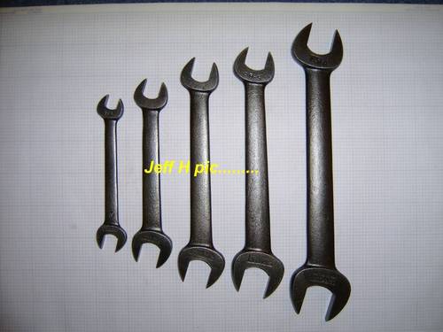

Postby Jeff H » Fri Apr 04, 2008 5:25 am
Here is what I do
1-beadblast
2-blacken with Birchwood Casey gun blueing
3-wax with Johnson's paste wax
larger photo http://64.69.39.188/g503/data/500/23FairmounT.JPG
larger photo http://64.69.39.188/g503/data/500/23S5300073.JPG

Postby Roger » Fri Apr 04, 2008 5:27 am
Here is what I do
1-beadblast
Very similar technique. Sometimes it takes a little more aggression!..... :wink:

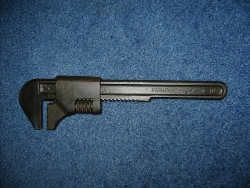

Postby Roger » Sun Apr 27, 2008 2:59 am
So, what to do... leave them as is, paint the wrenches... what about the pliers and adjustable wrench?
Mark, I haven't had very good luck with painting pliers. I've found that a good cleaning with a fine bristle stainless brush works best for getting close to original finish. Hand cleaner or WD-40 works good as a cleaner with the brush. I stay away from wire wheels if possible.
I picked up on a tip that Luca gave for painting hub sockets. Black Flat Paint, You can rub with a little oil when dry to give a little luster. It works good on wrenches also. Not as shiny as gloss and doesn't show the flaws.
All but the 27C in this picture were re-painted.
I get pretty good results with the 11" adjustable too.
