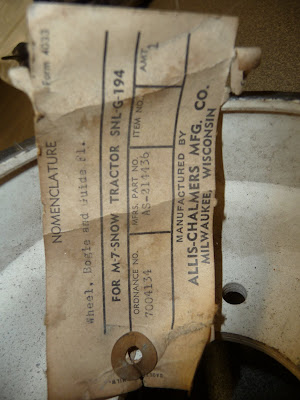

Hi Gordon,
Robert makes very nice data plates, he made mine for the M7 and it is just excellent:
The one at the bottom, I recently bought from Jaap and this is the one that appears in the parts list for the M7.
The pre-heater for the M7 has no electrical ignition.
Thanks for the offer.

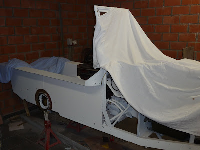

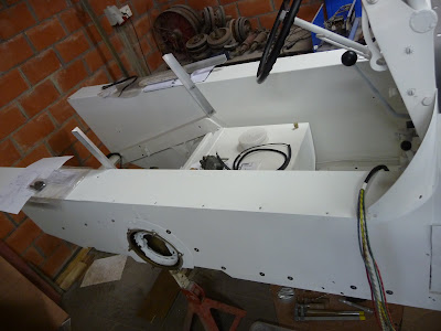

Postby Mountaineer » Sun Feb 05, 2012 7:15 am
got a few more things done the last couple of weeks ...
Shat-R-Proof glass installed
Body parts sandblasted and painted
New rings that fit around the rear axle
a few NOS parts
Pre-heater Flue with "grey speckle"
2 NOS Dash Lights
More body parts
Accelerator pedal made from scratch

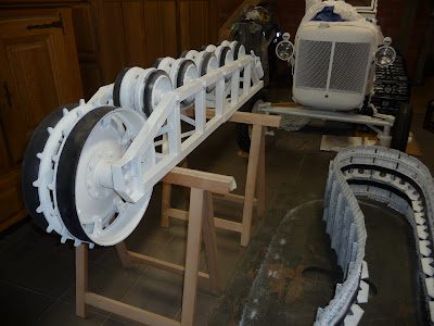

Postby Mountaineer » Tue Apr 16, 2013 9:35 am
After a long stop, I've been working on the M7 again for about two weeks.
My dad has been so kind to help me with the tracks, boogie wheels and stuff ...
One track installed and outside painted with a rubber coating ...
And a few small details added
Should be ready in two weeks for it's first show which takes place from 4 may till 12 may.

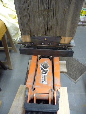

Postby Mountaineer » Fri Apr 26, 2013 11:52 am
Started to work on the lefthand engine cover today.
Didn't know how it would turn out making the louvres but to my surprise it went very easy.
Made my own louvres press ...
Made some slots in the cover ...
and started pressing the louvres ...
And the result ...
Cheers
