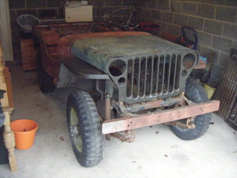

I never posted mine in this section when I got it, so here goes!
Its a mid June (14th/15th) 1945, chassis number 272270.
She was in very poor condition when I got her, the front end had been seen to by bubba - front crossmember removed, blocks put inbetween the spring hangars and the chassis to raise it and various brackets and pieces of metal 'added' here and there.
I've completely disassembled her now for a nut & bolt rebuild. There was no engine present when I got it, or gearbox... or transfer box for that matter! But I now have a wartime MB block + GPW head to go in! It also had an m38A1 back axle, but I now have the correct axle to put back on it.
Brief history; Assembled so late in the war, it probably saw little/ no wartime service. Post war (1947ish) it was used by the US Navy (land based) and mounted with a mobile generator to start jets on the runway - it had a takeoff from the transfer box hence the holes in the transmission hump, also a rev counter mounted in the dash to keep a track on the extra generator! I've been told that if it still had the original hood, it would have a strange stamped 'bubble' in it. As a result of being an airfield jeep, it was painted yellow all over - chassis + body. I think it was then sold to a farmer in the 60's and was fitted with a chevvy V8, which stayed with the jeep right up untill it was shipped over here to the UK (the V8 stayed in the states).
Some pics as it arrived:

Postby gpw-sam » Sun Feb 26, 2012 2:18 pm
Thanks chaps!
A lot of work has been done/ parts aquired since these pics were taken (i'll get some more up to date pics soon).

Postby Einar » Mon Feb 27, 2012 5:25 am
Hi Sam
Is the chassis serial # 272270 stamped somewhere on the frame?
Einar F.

Postby gpw-sam » Mon Feb 27, 2012 6:55 am
Hi Einar,
Yes, the chassis number for GPW's is stamped directly into the chassis rail (passenger side).
Take a look at one of my other threads: viewtopic.php?f=4&t=199726

Postby Einar » Mon Feb 27, 2012 8:25 am
Beatutiful :)
A GPW frame with a modified front crossmember channel then. Should be easy to replace with a correct one.
Can you check the body number?
Just to inform you; I have one of the sisters to your jeep, with serial # 272045. It is a running project :wink:

Postby gpw-sam » Mon Feb 27, 2012 12:10 pm
Yeah I have the correct front crossmember now, it's in the welders this week getting put back to 'stock' condition. I'll post pictures when its finished :)
Wow, your chassis number is very close to mine!! only about 150 apart, I think thats the closest i've seen yet to mine. Do you have any pictures on the G of yours? it would be interesting to compare :)
Mine has the factory fitted deep mud exhaust bracket on the rear of the chassis (on the A frame), does yours also have this fitted? aaaaaand, do you know which factory yours was produced at? :mrgreen:
