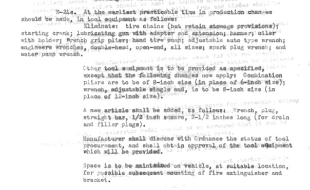

Postby Bob W » Fri Feb 03, 2012 11:12 am
Looks like the M-38 was originally specified to received a "full" set of tools from the vendor, but after testing the Pilot Models it was decided to eliminate many of the tools. Check out this paragraph from the 7 April 1950 Pilot Model Inspection Report for Truck, 1/4 Ton 4x4, Utility, M38, (Willys) Contract W-20-089-ORD-4758 by the Army.

Postby Joe Friday » Fri Feb 03, 2012 11:39 am
Thanks Bob. That is EXACTLY the kind of information we needed.
I'm still curious that there was a 2nd number assigned to a tire pump for M38 at a later date. I'll try to follow up on that one.

Postby Mark Tombleson » Fri Feb 03, 2012 3:23 pm
BA wrote:This page from M38 CDN operators manual SE 363 June 52 shows tool kit issued.
was the US production vehicles (M38) issued "same" kits?
So, it looks like we are close to what is shown in the M38 CDN manual.
Wheel nut wrench
Jack and handle
Drain plug wrench
8" pliers
8" crescent wrench
And possibly...
Screwdriver
Tire gauge
U.S.N. 133818
Mark Tombleson
MZ Radio Operator
Posts: 7692
Location: Sacramento
