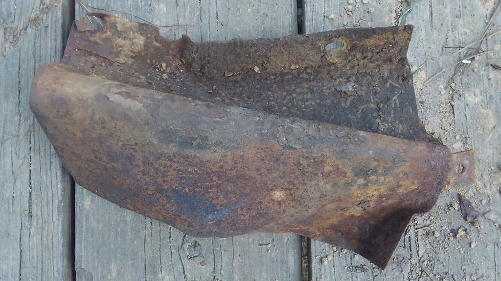

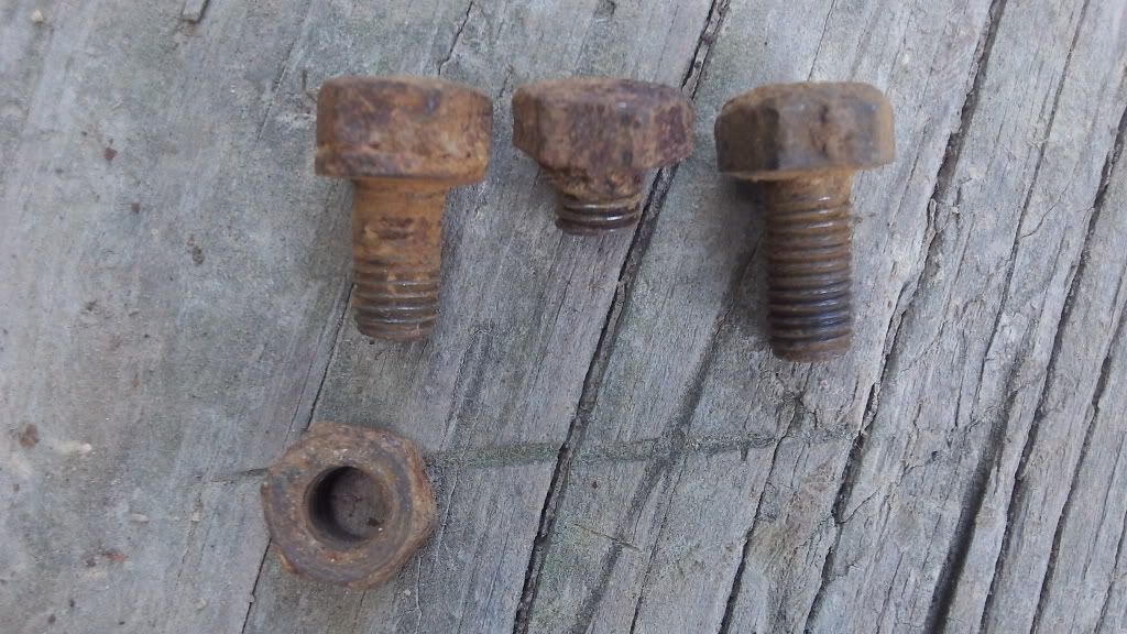

So as I said, I spent about 45 minutes stripping a few more items off the frame beginning with the generator shield. 3 little 7/16th bolts hold it on. The one under the motor mount is a bolt and nut. The two in the frame have captive nuts inside the frame. Meatloaf once crooned that 2 out of 3 ain't bad. In this case it is.
One broke off inside the frame. :evil: I think that makes 2 or 3 broken bolts left in the frame I'm going to have to deal with soon. I was planning on using as many of the original nuts and bolts as I could salvage but now I am seriously having second thoughts about that. This bolt today was not even under a lot of pressure when it broke. It was turning easy... then just wrung right off. How do I know that they won't snap under daily driving pressure? I am thinking I am going to order all new nuts and bolts from Ron when I go to putting this thing back together.
Bolts aside I was able to get the shield off. Boy does it look sad and abused.

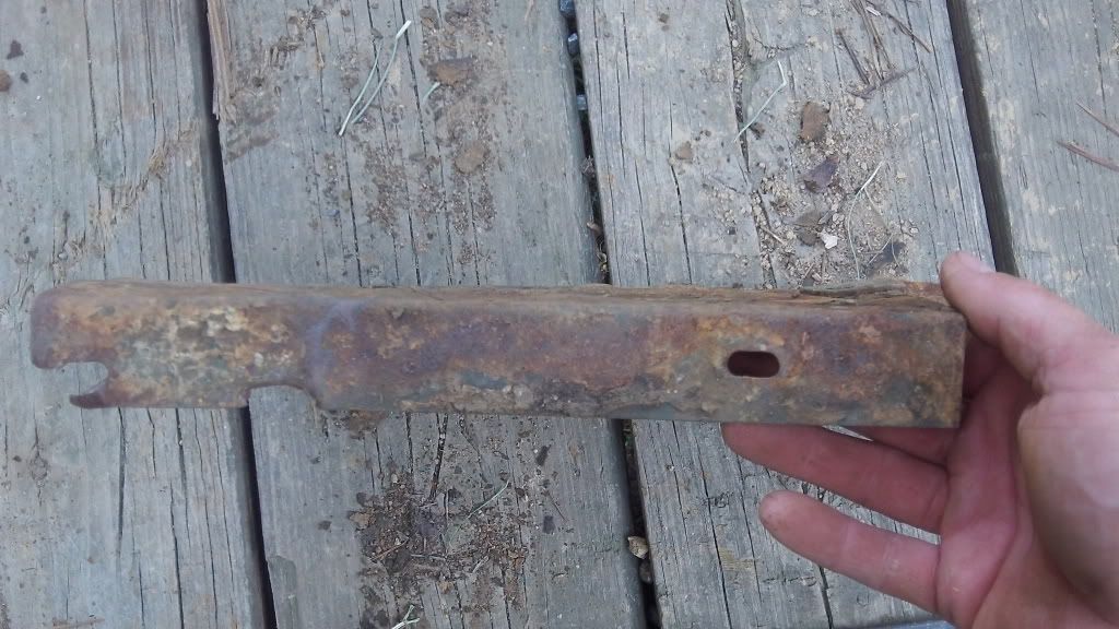

I then moved onto these little things. Are they some sort of bumper for the springs? I need to look that up. Two 1/2" bolts apiece with captive nuts inside the frame. You can't see it in these pics but there is another bolt for me to drill or ease out. I had to cut one due to a stripped head. I probably could have cut a slot in the head and used a big screw driver or waited until I procured a pair of vise grips or something. But supper was close to being done and I wasn't thinking straight... sooooo... out comes the grinder! :oops: :roll: More work for later.
These look pretty sad... kind of squished. Add that to the order list.

Postby The Raven » Wed Jun 20, 2012 4:05 am
Broken enough bolts myself. It's amazing how weak they are isn't it?

Postby Fat Albert » Wed Jun 20, 2012 5:30 am
Scary easy sometimes. Makes you wonder what is really holding things together. :shock:

Postby philbrinson » Wed Jun 20, 2012 7:10 am
Dutch;
That is just the metal backing plate for the axle bumpers. As most of them are usually found, its missing the rubber bumper part. The deformation is to give the rubber something to key into when its formed together.

Postby zepher11 » Wed Jun 20, 2012 7:48 am
Yes, those broken bolts are a real pain to deal with. I had a few on my project, but it looks like you won the rusted bolt lottery. It is a time comsumer for sure getting them all sorted out. If any questional bolts show up, I would replace them. Especially if they're in an area that is criticle to the operation of the MB. I have been trying to reuse all my F marked bolts, but some were just not up to the task.
Keep plugging alone. It's tedious work, but it will provide satisfaciton in the end! :wink:

Postby The Raven » Wed Jun 20, 2012 6:14 pm
One thing I've been doing with my bolts is chasing them with a threader. Cheap process to make life easier. Kroil works good too
