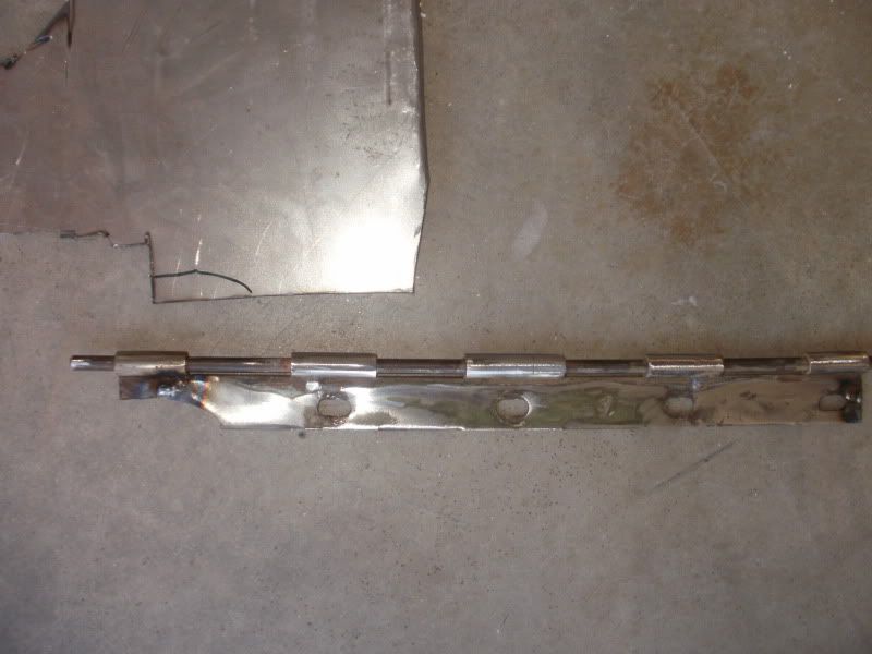

My hood hinge was cracked and missing a chunk of metal. I wanted to preserve my original "F" stamped hinge so I repaired it by welding a new piece of metal onto it. I still need to drill out the hole but it turned out just fine.

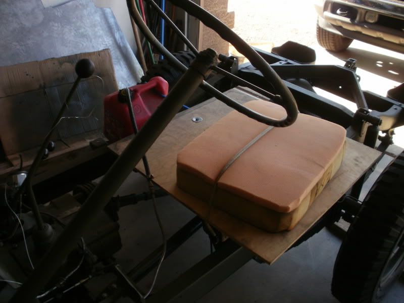

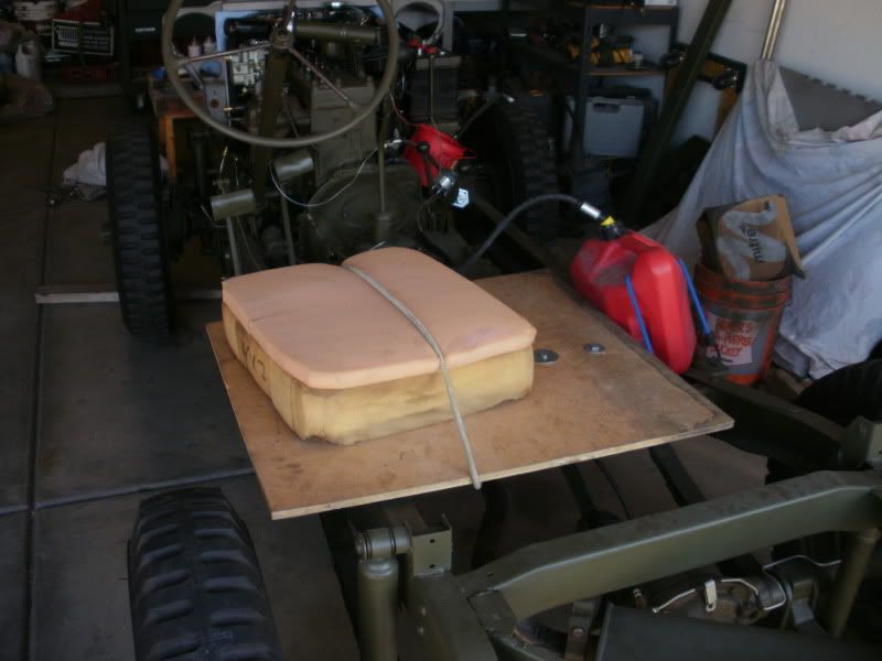

I test fitted the tank with the new seat and everything looks like it will line up.
