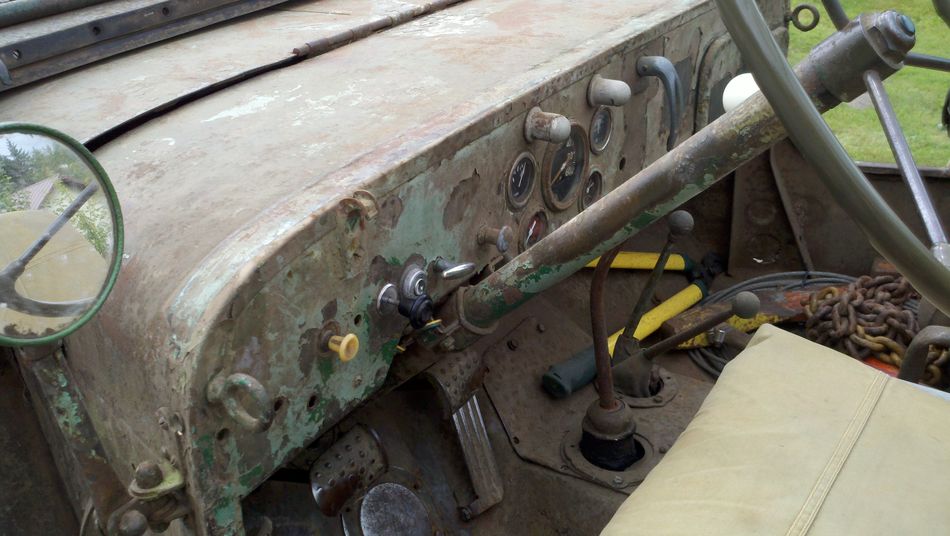

appears that fuel and temp are original paint can gauges.
GPW 7974 Gauges.jpg (150.51 KiB) Viewed 921 times
it at one time had a M48 mount attached as the third data plate is mounted left of the glove box. Glove box door has been rewelded back to add teh missing part. it appears teh holes are there from the M48 mounting.

Robert....the FUEL is a paintcan...but the TEMP is a postwar SW I think....

Postby Ian Fawbert » Fri Jan 06, 2012 10:13 pm
Hi Chuck,
Are you looking at the top right gauge or the bottom right one? Top right is a post war ammeter i think and the bottom right is the paint can temp- all assuming they are in the original positions!

Postby lt.luke » Sun Jan 08, 2012 11:06 am
Depending on price, I'd like to have the mirror & arm (complete).

Is that the choke or throttle knob? I'd like to be considered for it and the associated cable.
What's the story with the windshield wiper that's on the windshield mounted to the jeep? There's not a clear photo. If I could get a photo, I may be interested.
