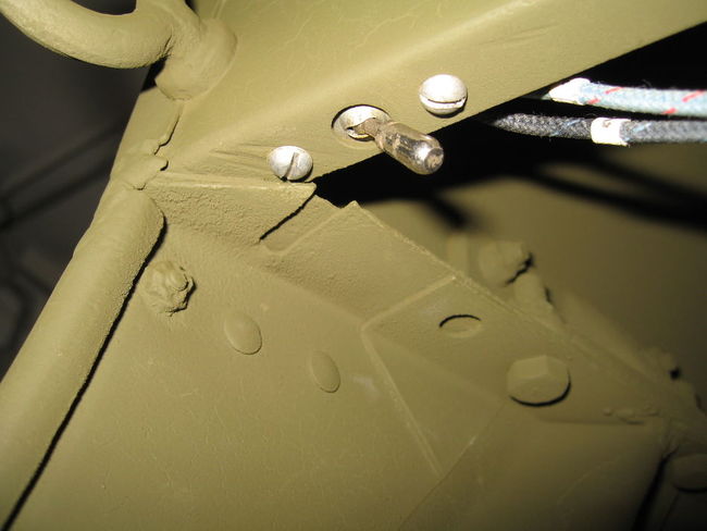

Can someone explain how the instrument light switch is mounted on the dash. It appears from the TM that it is mounted under the dash' pointing' down toward the floor. I would appreciate a photo if anyone would be so kind :shock:

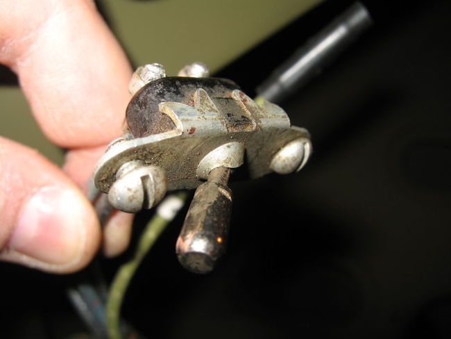

hope this helps.

Postby stew » Wed Jan 26, 2011 6:11 pm
maurizio,
Thanks for the pictures!!! Is the location where you found the holes already drilled or did you choose the spot to mount the switch? Mark :D

Postby Rory Grenier » Wed Jan 26, 2011 6:22 pm
Yes this is the correct location for the switch, the holes should be in your GP in the same spot.

Postby stew » Wed Jan 26, 2011 6:46 pm
I bought the Andy LaBorde GP. He did extensive body work as did Jim Mulligan (an excellent job I might add). The holes are not there.
Thanks for the help! Stew

Postby Rory Grenier » Wed Jan 26, 2011 8:53 pm
Stew,
make sure there is not putty or they have been welded shut. there could been a chance the front of the dash was replaced and they did not put the holes in for the switch. Good luck
