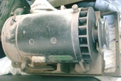

Postby Mark Tombleson » Wed May 19, 2010 4:34 pm
The 12v generator will look like this:
Note the small pulley, but your 12v one will have a green tag instead of the 24v off white tag like mine.

Re: U.S.M.C. MZ-2 Radio Jeep restoration.
Postby F. R. Fox » Wed May 19, 2010 7:58 pm
Thats exactly what it looks like. Sweet, Ive never had this much luck finding parts to my standard jeep! :D
