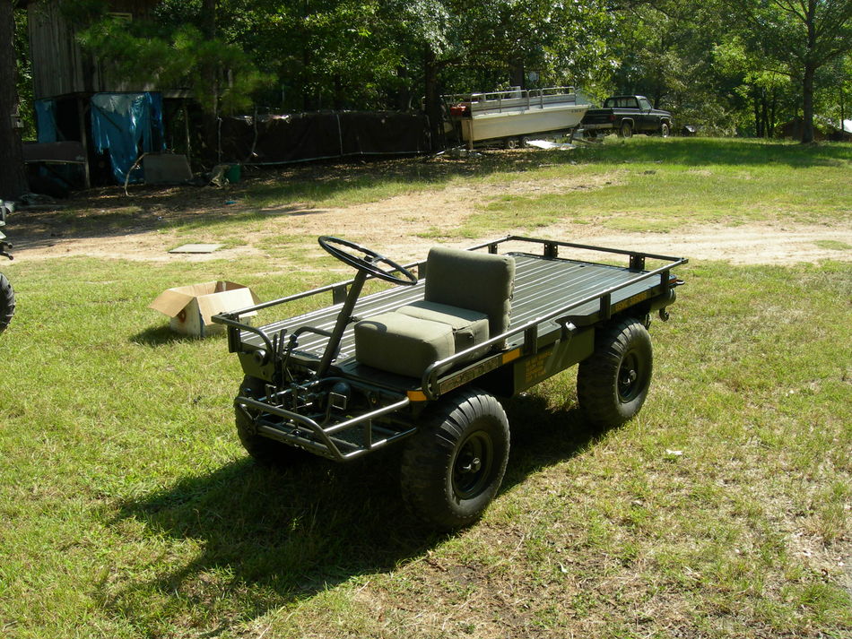

This is one that we did for a customer that turned out really nice. A lot of work went into this mule, but it was a show winner after we got finished.
