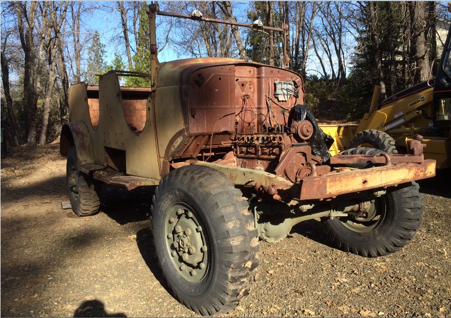

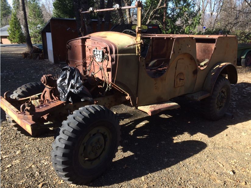

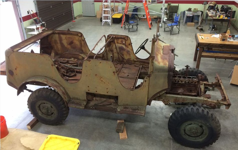

Well, Mr. Johnson entrusted me with the restoration of this Dodge WC16 Radio Command Car many years ago. This was just too close for me to not take a look at...about an hour north of me. Bill is a class act. With so many parts, I remember I had to make two loaded trips home. Bill also towed down a trailer load in addition to me on my second trip! All made it to my place safely until the restoration bug finally got me.
I know next to nothing about Command Cars...let alone radio stuff. I would like to restore it back to its former glory, but not sure about the availability of the radios that these had. In any event, it will be a great research project as I learn along the way. I really like the straight body as well as all of the little original door hardware etc... that are still in place. The floor needs a little rust repair, but overall there doesn't appear to be much rust repair to tackle. Missing a few items like the bows and rear seat frame and radio box. Most of the front seat frame is there. Bill had already found the hard to find gauges for the radio car, so I don't need to search for those. Here are some photos with her all tucked in now:

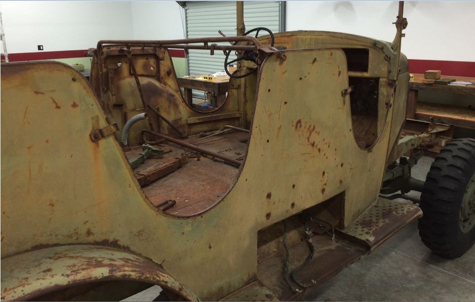

She looks pretty solid.
With that nice new work shop, no shuttling stuff around to work on her.
Has she gotten approval from G & G Services?
Mark
Mark

It will be nice to not trip over everything now with the extra room to work. G & G have gave it the once over and give it two paws up!Mark in Tucson wrote:She looks pretty solid.
Mark

Great project Zepher11,

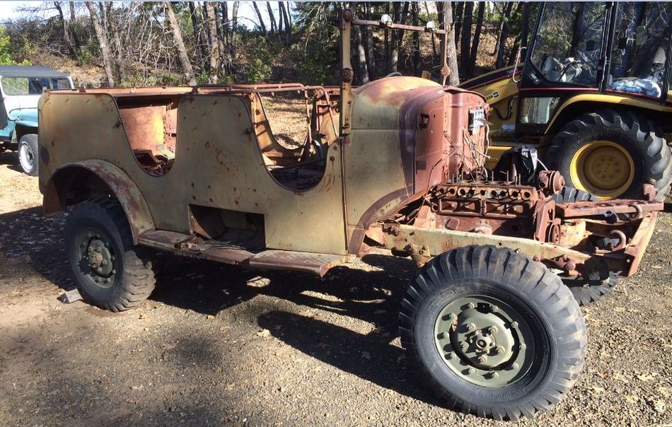

I can't get over how rust free, complete and straight the body is.
Nice find,
Kelley
Nice find,
Kelley

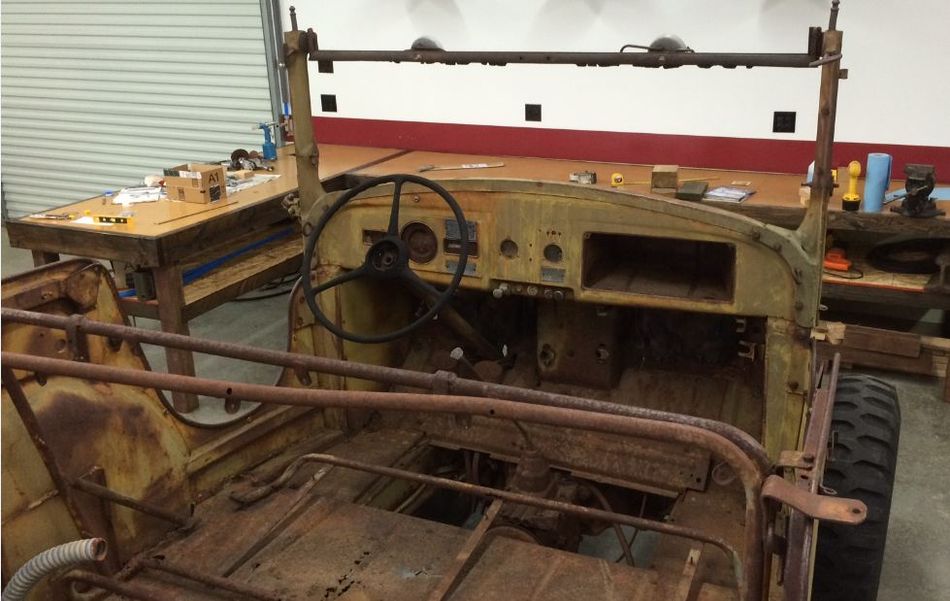

Thanks Kelley. I found a few more more rusted out hat channels and wheels wells underneath, but overall the body itself is in really good shape. Hat channels and floor replacement, I hope, will be the only metal replacement. At least any metal replacement I complete will not be easily seen. Takes the pressure off a bit so to speak.kelley wrote:Great project Zepher11,
Nice find,
Kelley

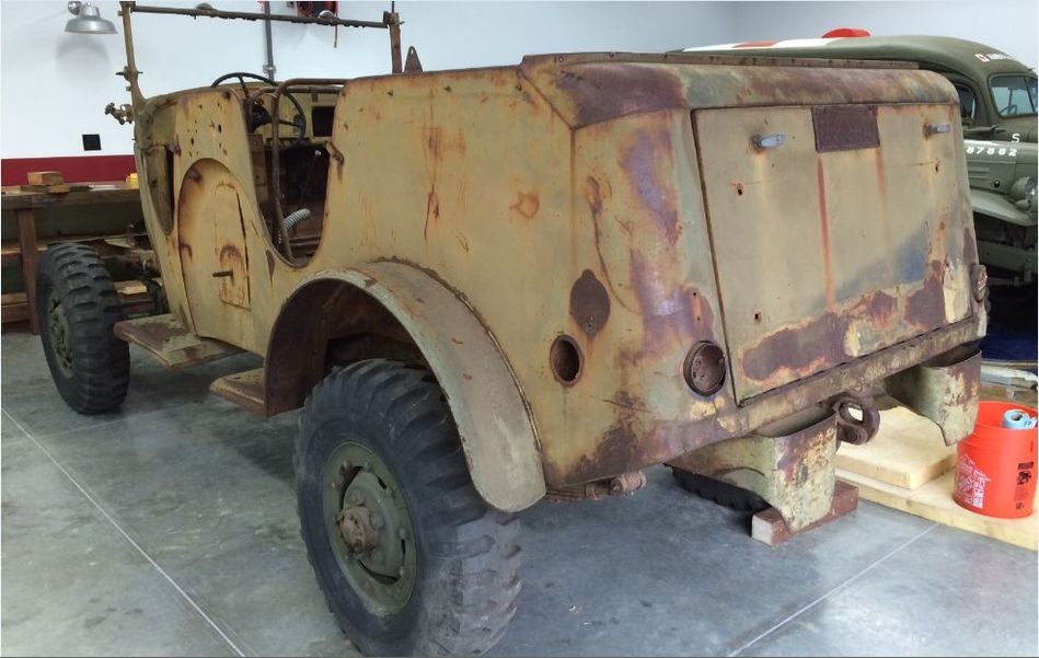

Are you planning on replacing the whole floor? It looks like MWM has the rear 1/3rd I'm not sure about the rest. The hat channels can be formed up anywhere.
http://store.midwestmilitary.com/product-p/mwm111.htm
Kelley

Hi Kelley,kelley wrote:Are you planning on replacing the whole floor? It looks like MWM has the rear 1/3rd I'm not sure about the rest. The hat channels can be formed up anywhere.
I actually spoke to John the other day, but neglected to ask him about the availability of floor panels for the 1/2 ton CC. I knew he had 3/4 ton CC floor panels. It appears to me that the rear 1/3 is in pretty decent shape on this CC. It's the front 2/3 of the floor panel that looks a bit sketchy. I will know more after I get after it with the sandblaster. The hat channels shouldn't be too much trouble...I hope...
I was just checking out your CC project thread a little earlier. I hadn't noticed it before. Looking good! Keep the photos coming. It's nice to follow along with the various projects here on the G. I learn a lot by lurking around on this forum.

Well I don't know about looking good, but it does look better than when i first got her. Mine will never be as nice as what you are starting out with, but i do enjoy working on it.
if you replace large sections of floor and hat channels i might suggest drilling a few weep holes in the channels to spray oil into from time to time.

Keep in mind that the asphalt looking coating you may find on the bottom side of the floor is the sound/vibration dampener used by the factory to quiet down that large flat floor.
Steve
Steve

Hmmm...I hadn't thought of that.kelley wrote:Well I don't know about looking good, but it does look better than when i first got her. Mine will never be as nice as what you are starting out with, but i do enjoy working on it.
I was trying to determine if it was caked on mud or something applied at the factory. Now I know. A lot of it is just lifting and looks like it was a perfect reservoir to hold rain water over the years to assist the floor in rusting through. I'll find some updated undercoating for the repair. I'm sure Eastwood has something that would be equivalent to the factory coating.SteveG wrote:Zeph
Steve
Thanks!

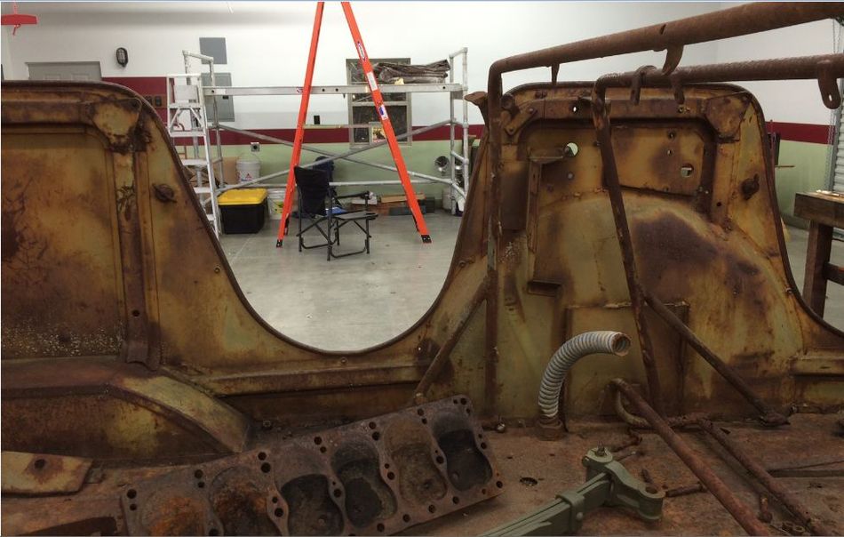

Welcome to the club! I'm working on one as well. Its all so much heavier than a jeep.
MWM has a lot of componants for the half tons they used not to. Like gauges and top frames.
If you come up with plans for the rear seat; please pass it on!
Check the bottoms of those frame cross-members; very rust prone!
Have fun!
Phil
Have fun!
Phil

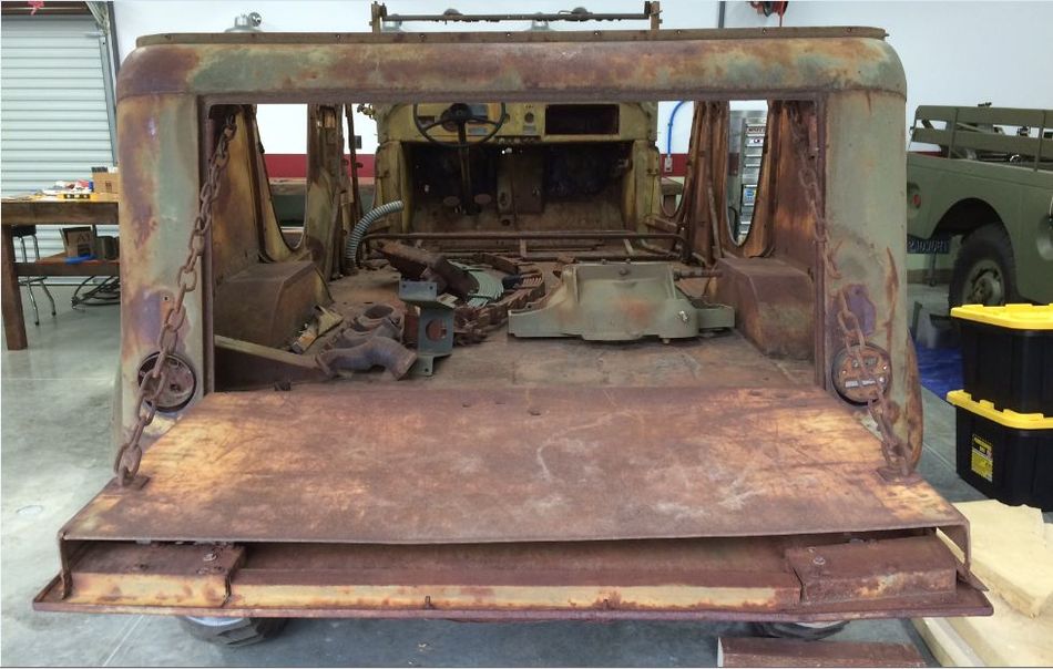

You are right. The CC is like supersized vs. the Jeep. I did check out those cross members a little and they looked okay, but will again. I did notice that what I thought were three missing rivets in the cross member(s), but then I realized that that is normal/common on the half ton frames. I will need to post a photo of what I'm talking about.
I spoke to John at MWM last week, and he said he will have the rear seat frames completed soon. I believe he said 60 days. No fronts frames. I have pieces of the front frame. I think I might be able to make one myself, or repair what is left of the one I have.
I am at the point of removing the body, but not sure how yet. It appears a bit rickety due to the rust in the side channels, floor and floor hat channels. The wheel wells are rusted through pretty good as also. I just don't want it to crumple on me.
Looking forward to getting it all apart so I can start putting her back together.

Put a couple of cross supports at the safety strap locations. As solid as this ones looks, I doubt you will have any problems at all. I pulled one that had no floor and another that had very little left. With the support at the cowl and the rear, its surprisingly rigid.
That's great news about the rear seats! Hurrah!
Phil
Phil
