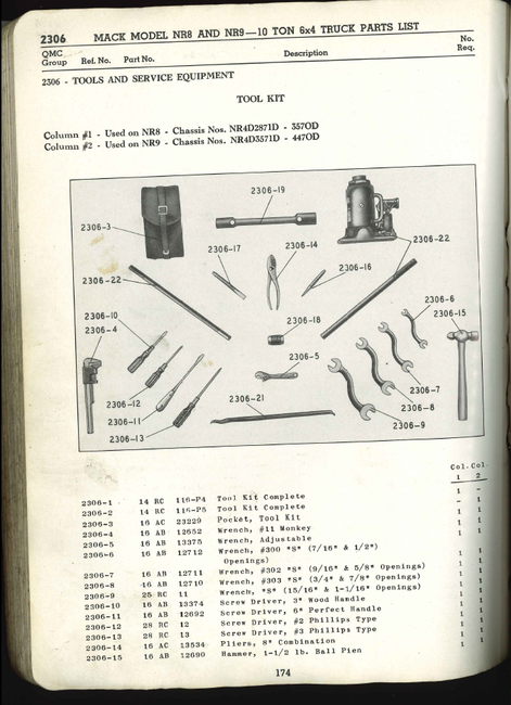

Hi Greg,
I found the Mack manuals I was after. I have the repair and parts manuals for the NM, but in the deal I also got the parts manuals for the Mack NR and EH models as well. In reviewing the tool kits, it turns out my memory was flawed. The S shaped wrenches belonged to the NR (10 ton 6x4). The NM and EH models both shared the same tool kit which had standard 15 degree DOE wrenches of exactly the same spec sizes as the MB/GPW.
So below you will see the kit and listing from the NR parts list. AND you will see your beloved little S shaped 1/2" and 7/16" pictured there. Mystery solved.
The quality of the pics isn't great - the hosting site just doesn't seem to bring them across well at all.

Post by Wingnutt » Tue Oct 31, 2017 5:55 pm
Thanks, Dave! I really appreciate your extra effort on my behalf. Looks like the figure stops at 2306-22, but the list includes 2306-23 through 2306-35. Was there another figure showing those tools? If so, and if you don't mind, please post it. ( 'I just may try to see if I can find the others,' I say, sotto voce.)

Post by daveus6 » Mon Nov 13, 2017 1:50 pm
Hi Greg,
There isn't another image of the rest of the tools mentioned. I'll check the NM and EH parts manuals as they may be pictured there.

I pulled this Williams "79S" (5/8 x 9/16) out of that pile.
It's plain steel finish, it has the wartime underline script logo and FORGED <W> USA marking and dead center shank, just like the Bonney, it has the Mack brand.
It matches wrench 2306-7, 12711, #302 "S" from the NR series toolkit list. No idea if it was really issued to the NR series truck kits any more than the Bonney, but it seems highly probable. If you look at the Williams 1942 catalog there is a big red "DISCONTINUED" notice on the page, so it wasn't made for civilians.
