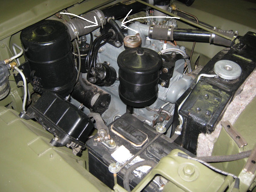

Made a little more progress this evening. I removed the incorrect glass top fuel pump. Let me know if anybody is interested in a known good working glass top CJ type fuel pump. I also removed the fan from the water pump pully. I researched several photographs of original and restored GPW's for correct paint characteristics.
I posted a question about a wiring loom piece I think I am missing as well as an add-on bolt bubba installed for his alternator bracket. I removed other pieces of bubba's alternator brackets.

The wiring loom piece:
The special bolt bubba installed:

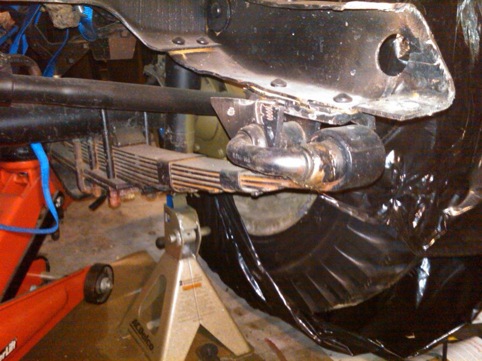

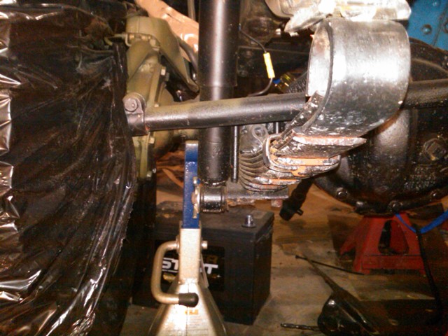

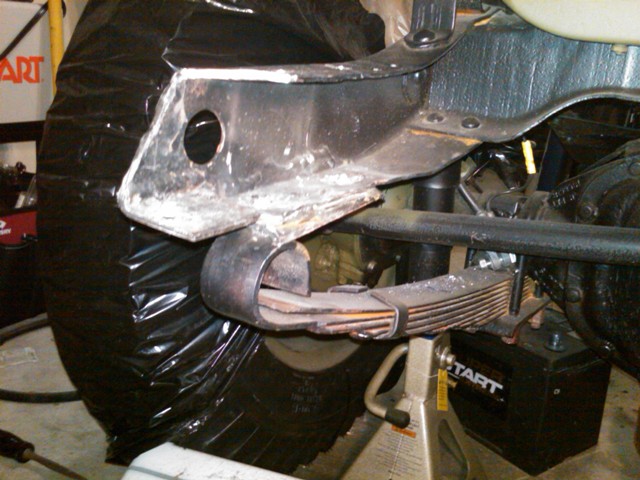

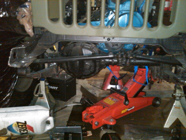

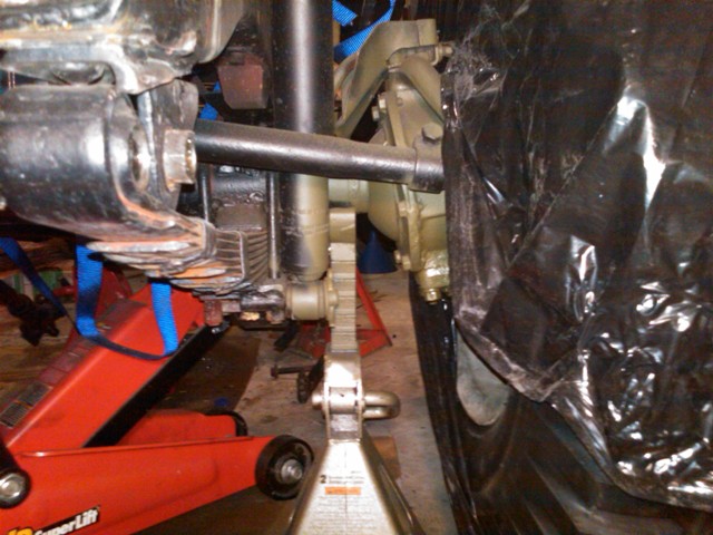

I cut the spring hangers off, but got a surprise. I thought I had the axle and all supported correctly but evidently I do not. The hangers came off but up popped the leaf springs against the bottom of the frame horns. Can you please give me sopme advice on how/where to support the frame/axle in order to take tension off the springs and allow them to fall so I can work on the frame horns?

Postby nick peters » Sun Jun 26, 2011 8:13 pm
Hey Rodney
If i had that job to do,id put a block of wood beneath the front cross member then jack the frame up from that point untill i had the spring shackles in the correct position.That will also help to remove the thread cover bolts if theyve got less pressure in the spring eyes(dont forget if the shackle has a little raised rib on the outer edge its left hand thread) Hope that helps.
