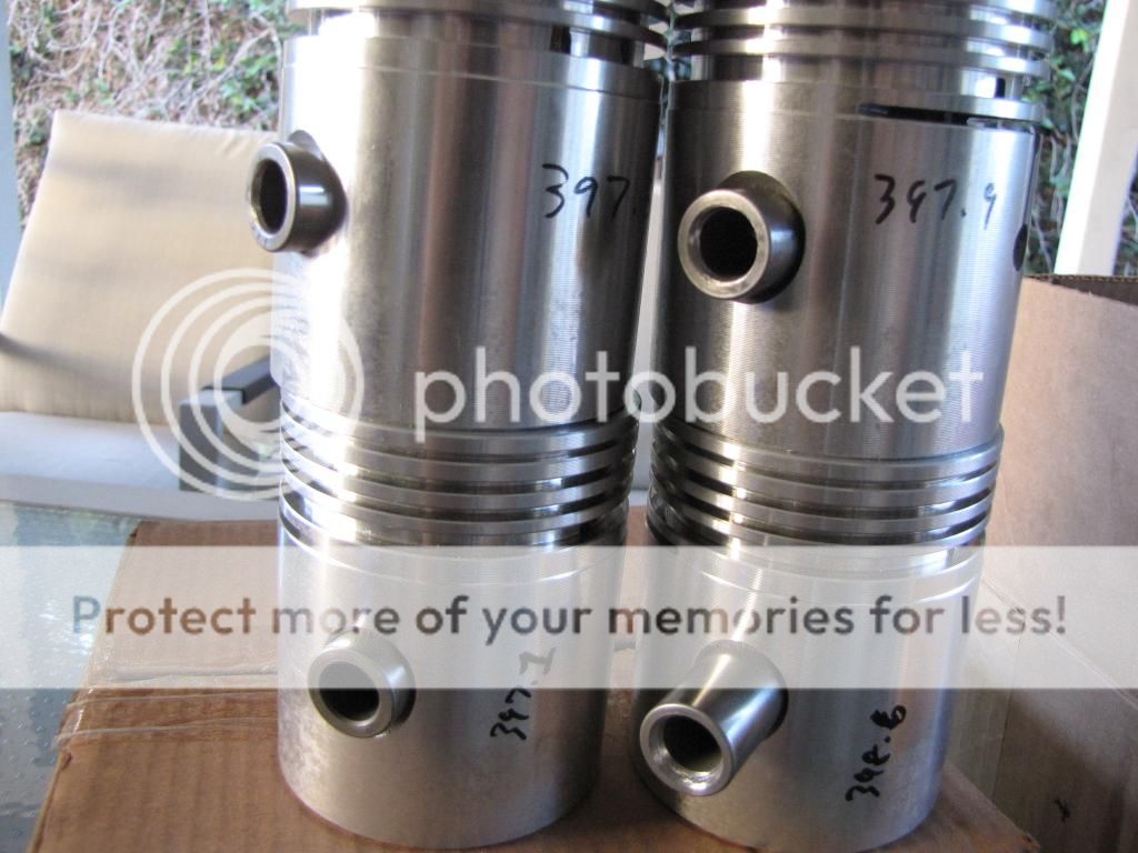

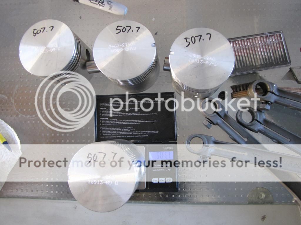

When I rebuilt a couple GPW engines a couple years ago, one for a friend, one for me, I decided to weight mach the pistons and rods. I was able to balance the four piston assemblies to be equal weight.
Like Artificer said, the piston pins sometimes were different weights and the heavy ones can be moved to the lighter pistons. A bit can be removed safely from the pins by slightly tapering the inside of the piston pin bores with a Dremel and a sanding roll. I also was able to remove a little weight from the heavy pistons by smoothing off the casting numbers on the inside of the skirts and smoothing some of the sharp machined edges, etc..
Total with pins:
Individual weights of just the pistons:

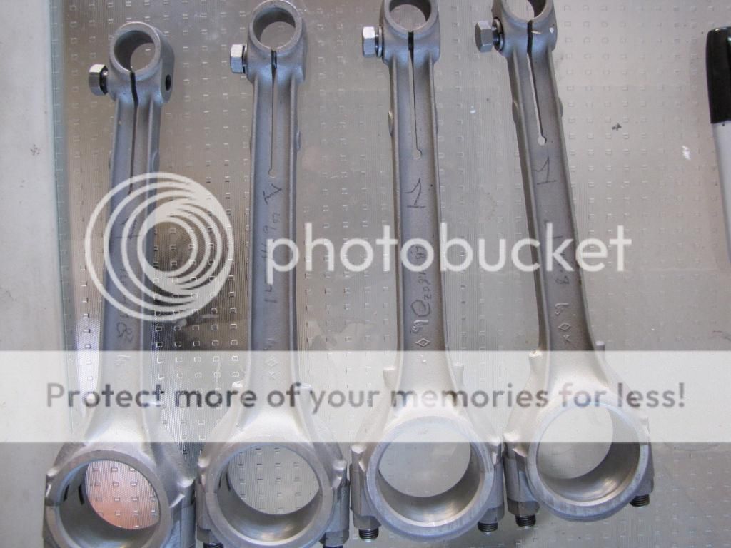

I also matched the rod's big ends and small ends weight, the pin bolt and washer make a difference, as Artificer noted! A slight polish of the forging marks and sharp edges on the rods made them equal up, along with matching bolts and lock washers. Note that I have four GPW rod sets, rods from different engines weights were quite a bit different. Points out that if you replace a rod or two in a set, be sure to have them weight matched.:
Weight matching connecting rods:
