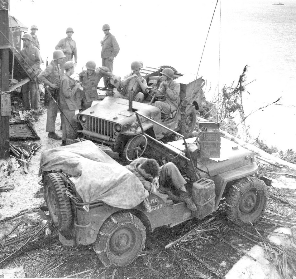

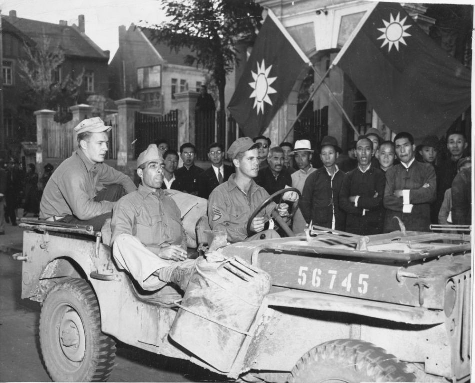

Post by gerrykan » Fri Jan 17, 2014 4:56 pm
Another photo of holder (made from round stock) on a Marine Corps jeep.
If you use a standard jerrycan holder you will need to space it away from the body to clear the windshield pivot point.
I'm sure most of the jerry-rigged holders shown allow the can to contact the pivot point, but I doubt these guys were worried about the long term effects of the can rubbing on it.
I think the halftracks used a stand-off plate between the holder and the vehicle body, but I don't know if it would be thick enough, or of the availability of them.

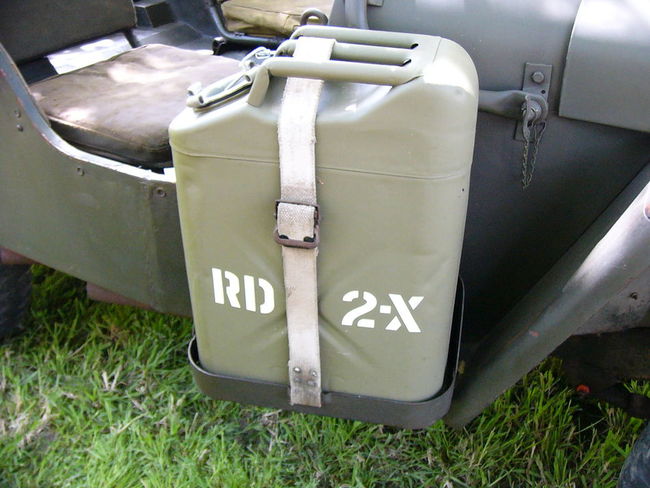

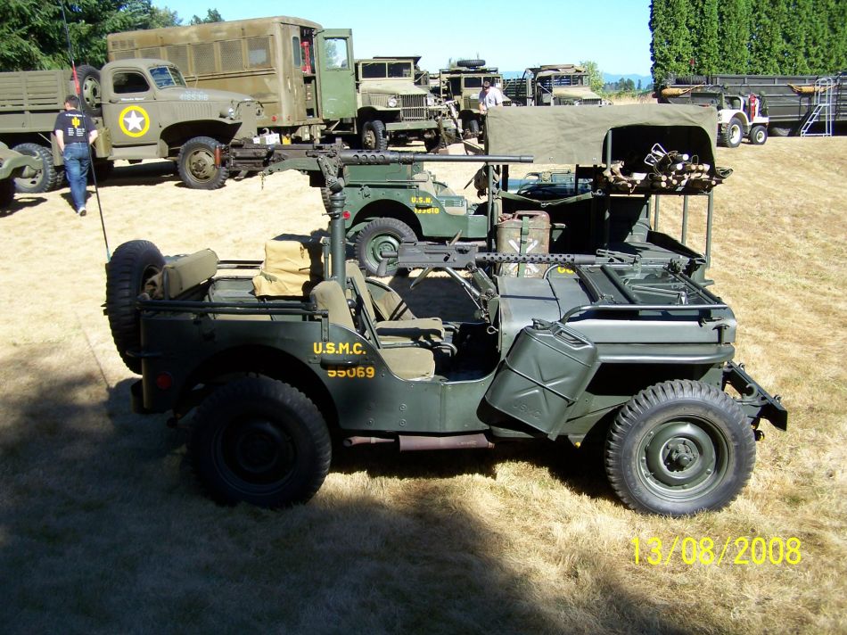

Here is a photo of one I took at Tower Park.
And here is that standoff bracket... from the link I posted earlier.
And here is a photo of Engagement showing a little better the Marine Corps. way.

Post by tommyhg » Sat Jan 18, 2014 12:47 am
rills only cut for desert jeeps
Most cans mounted on step just by piece of bended shaped bar welded to jeep, and can dropped in, jerrican rack there looks artificial
