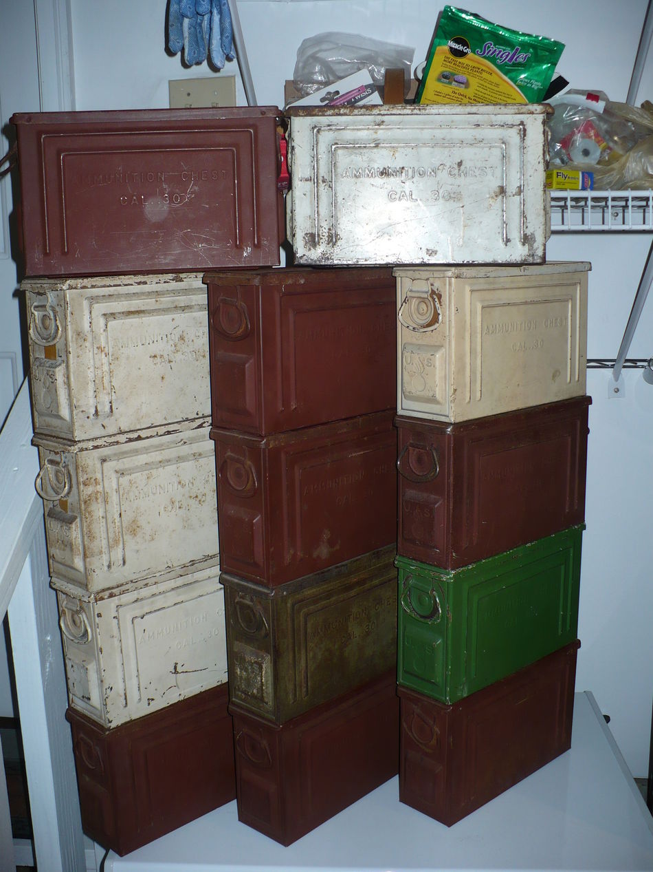

I can vouch for the TM9 paint. I've used it to repaint at least a dozen WWII .30 cal M1 ammo cans, and its a precise match to the nice originals in my collection.
Plus, Paul is good people...always willing to advise and help.
His paint was used on the can in the lower left...matches the two originals on the right.

White, Green (dark) or red primer are all acceptable for tank ammo cans....
