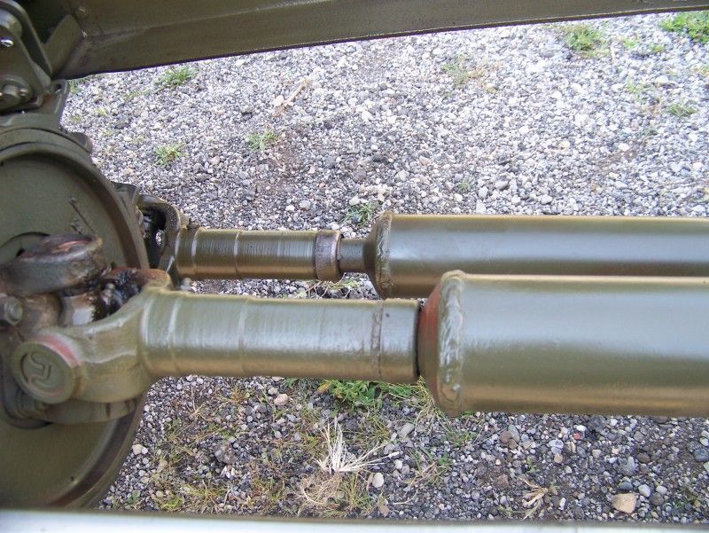

Hey Question for you all
Should I have any clearance with the shaft?? On my rear rear drive axle I have some play in the drive shaft but the front rear drive axle has no play in the shaft take a look
Thats all for today.

Re: Working on the Studebaker "Cab Installed"
Postby Shane Hodby » Tue Aug 21, 2012 2:22 am
Hi Ken
Bad news you need at least 2inches travel between the end of the female and the front of the big male piece of the shaft or you WILL stuff your universal joints, your talshaft can bend and maybe punch the end of the transfer case in looks like it could be the wrong shaft You can get it shortened to the right length also when you redo your seal take the breather out and soak it in petrol and then blow it out with air also do your gearbox and diffs and pillow block if they are blocked with dirt etc you will always have leaking seals also put a triple lip neoprehene seal in and check your yoke for grooves you may need to put a speedie sleeve on it or get it built up
Cheers
Shane

Postby Lowrdrbird » Tue Aug 28, 2012 6:08 pm
Well
Got the driveshaft shortened along with the new seal and she drives great. Took her out again for a drive and it was able to make it up to 43-44 actually saw 48 but we were going down hill. Had a buddy of mine come down from Wisconsin and he got to drive her a little bit. He had to get used to the shifting pattern said it was really funky. But he likes how shes drives. I am hoping to have the wind shield in this weekend so that I can take her to a local parade on Monday she wont have the bed on her yet but will be mostly there.
