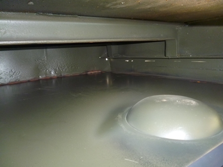

Check the thickness of your toolbox floor, your replacement looks a little thick. Also there was a hump built into the floor, above the pintle hook to allow clearance.

I used 1/8" mild steel sheet for the floor. It seemed about right.
Yes, that hump in the floor plate. Well spotted! It was only later that I noticed it on my other truck. I have since fixed it and it will show up in a post before too long.

Anyway, some time back I fitted a new toolbox floor to the wrecker body, only to later find that, as John pointed out, there should be a dome in the floor to clear the pintle hook when it spins around. So the hunt was on for a suitably shaped and adequate gauge steel dome to fit. There is a surprising variety of items that are in the running, eg. water pump pressure chambers, air compressor tank ends, sealed fridge motor chambers, etc.
I used a fridge motor chamber, just cut the end off with a grinder, cut a matching hole in the floor, and welded it in.
One more job done. Now, to the toolbox door.

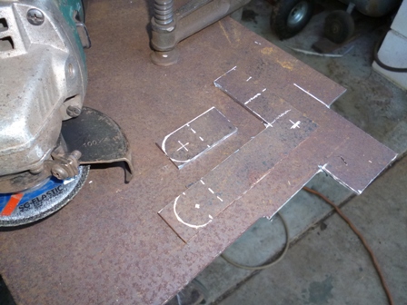

Anyway, a while back, I set about making a Tool box door for the rear of the Wrecker Tray. As with much of the 969, it is 16g (1.6mm) mild steel, so I just copied one from my un-molested truck.
Firstly, measured it up, marked it out on flat sheet, cut it out with an angle grinder,
folded it up and welded the corners with a MIG welder.

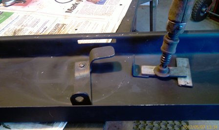

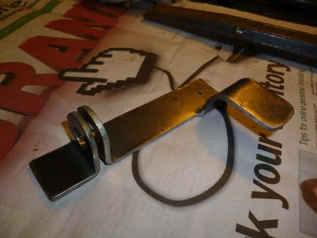

Then I did the same for the catch, except it was 1/8" steel.
And did a "false" spot weld and a 1/4" wire rivet to hold it in place. The pic below shows the small part held in place prior to welding.
It was only then that I realized that I had goofed . . twice. Firstly, the lid is over an 1" deep, it should be 3/4" deep, it is going to stay that way. Secondly, I fitted the welded part of the catch lower on the lid than my original, thinking that the angle of it looked awkward. I now realize that it needs to be higher so that the padlock will lay flat in the lid. It is going to be moved to the right place.
