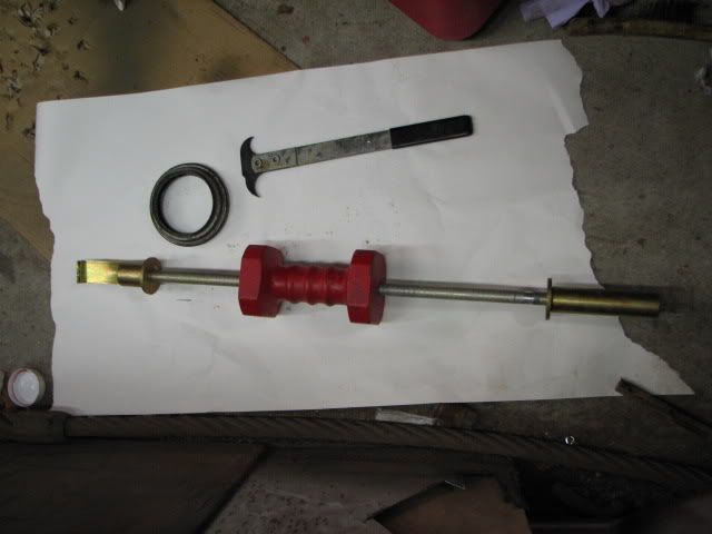

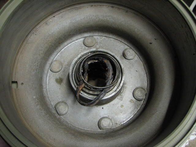

Next I replaced my rear wheel seals. The rears are more difficult than the fronts since the rears have a retaining ring and the seals are much heavier than the front so they require different pulling tools the the fronts. The front seals come out and go in like any car seals.
The first step on the rears is to thoroughly wipe them clean so you can see the retainer and the notch:
Secondly use a heavy duty pick to pick out the leading edge. A thin pick will bend:
Here's the ring out:
This shows 2 types of pullers - the smaller one you'll recognize as a typical seal puller for a car wheel. This will work for the front seals since they are thin and easily removed with this tool. The rear seals are much heavier construction and will not pry and bend out. You will need to use a slide hammer with an L-lip attachment. This puller is a universal body shop puller with a 5lb slide hammer and a fixed heavy butt end and the other end is threaded to allow a dozen different kind of fittings:
First though you will have to pull the inside guts out of the seal so that the slide hammers L-tool can fit into the seal. You can use the standard car seal puller to pull the insides out. Here's a photo of the inside bits you'll be pulling out:

Postby Ben Dover » Sat Jun 30, 2012 7:46 pm
Why not remove the seal by driving it and the inner bearing at the same time?
Ben Dover
Posts: 22654
Location: Proving Ground
Re: Finally got my restoration started on my GTBA
Postby acmack » Sat Jun 30, 2012 8:07 pm
Joel, that's an old school/cheap way of doing it and that's rough on the bearing. You're slamming the bearing against the seal. Use the proper tools.

Postby Ben Dover » Sun Jul 01, 2012 2:28 pm
How do you think races are installed?
Ben Dover
Posts: 22654
Postby acmack » Sun Jul 01, 2012 4:26 pm
Seriously Joel?
I'm sure you can do all sorts of automotive repairs with just a hammer and a cold chisel. Take a look at my earlier post regarding axle nuts.
The races are thick solid pieces of steel. The bearing assys are much thinner formed metal cages.
BTW the races are better installed with a press not smacking them in with a hammer. In combat as a field expedient sure, you need to work quickly with what you have. But for restoring 70 year old vehicles or a vehicle you really care about use the correct tools.

I use factory tools when available, my Snap-On tools, and all kinds of drifts for these jobs, most wheel seals readily pop right out with little effort or risk to the wheel bearing. Simple methods do work, Wheel bearings take quite a pounding on their own with normal driving, especially if there is a little play.
Was just sharing a bit of shop talk.
