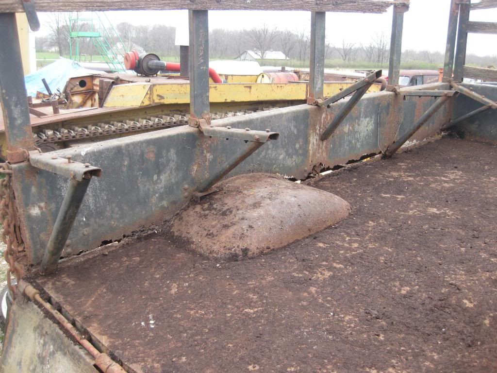

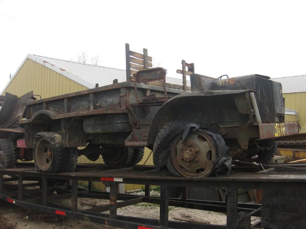

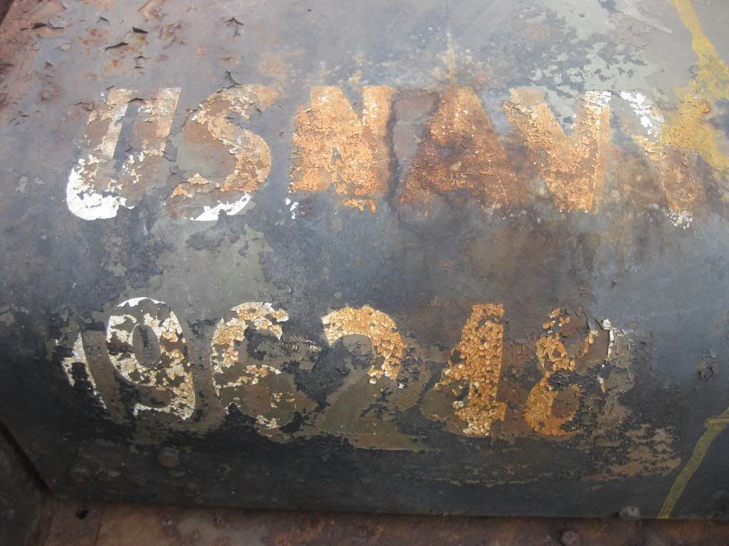

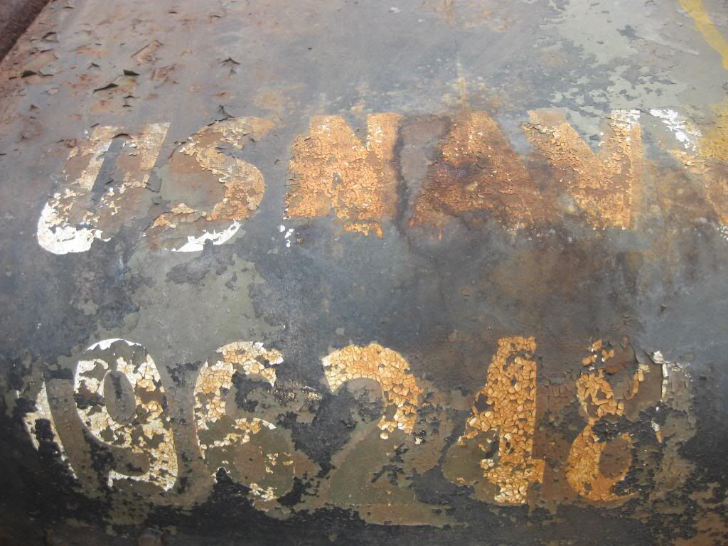

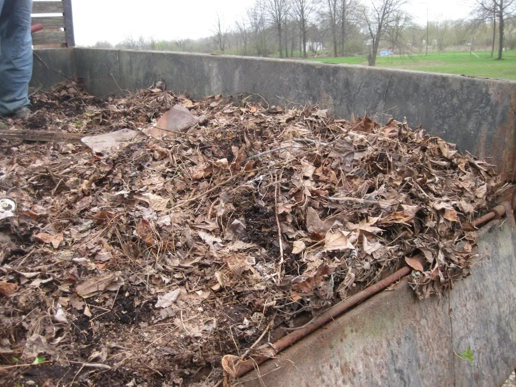

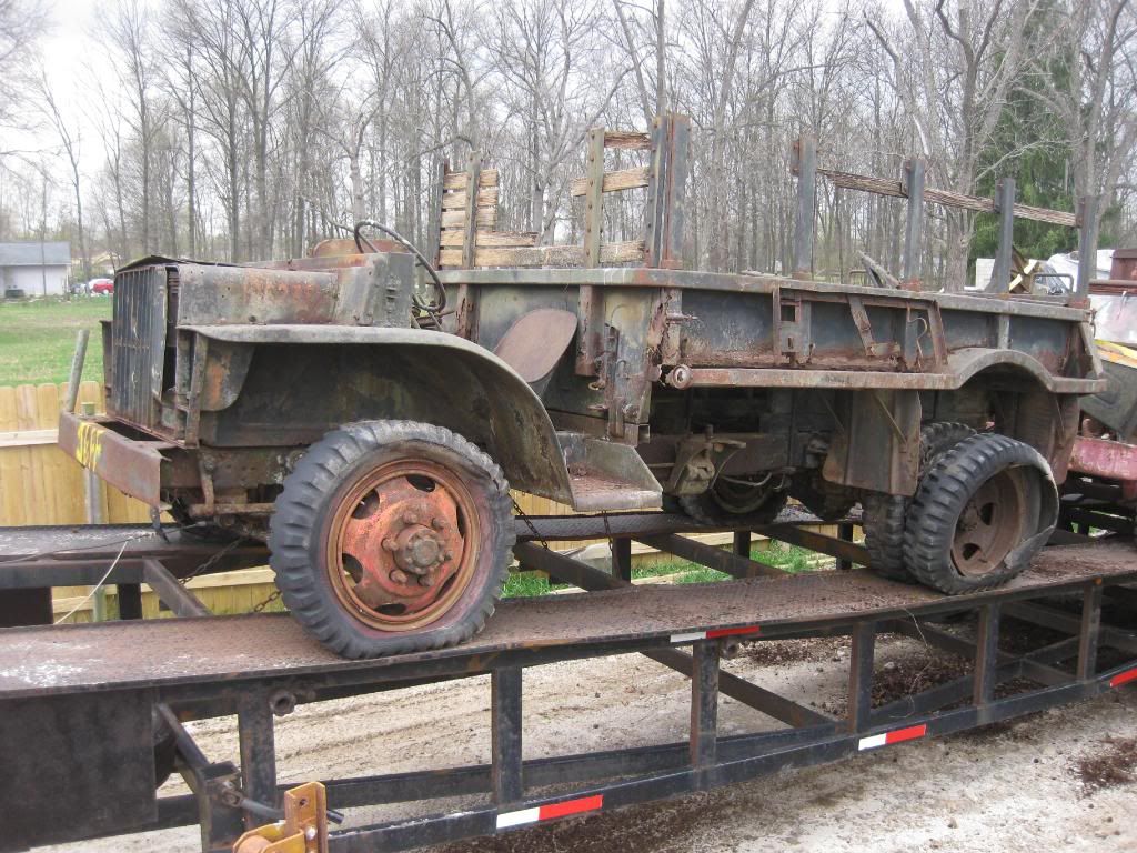

here is my save from, "china" the cover is for Joe's berma, i'm trying to find the "other cover" sold at the auction, jim henry, from NC, kept them at his place(thanks ) till i could get down there,, i think i win "the MOST AWARD", dug out dirt trash award at three FULL, heavy trash cans, just out of the back cargo area do i win, "RAN WHEN PARKED?" award? ,, i'm sure the motor is JUNK, but this berma has alot, of the TRINKETS,, and eye candy,, which i could repo,, (if i get time), i'll be looking for a donor truck, and or another berma,, here is mfgunner 's
http://www.bigshotsofidaho.com/pictures/BurmaFord.jpg
i'll be up your way to get those HT rear racks, are they on your site?
i also , found the rest of the rear racks, some top bows, and half a windshield :lol: in the leaves!!
USA 1/2 vrs CHINA 0 and the kd64, makes a solid 1 vrs china 0
