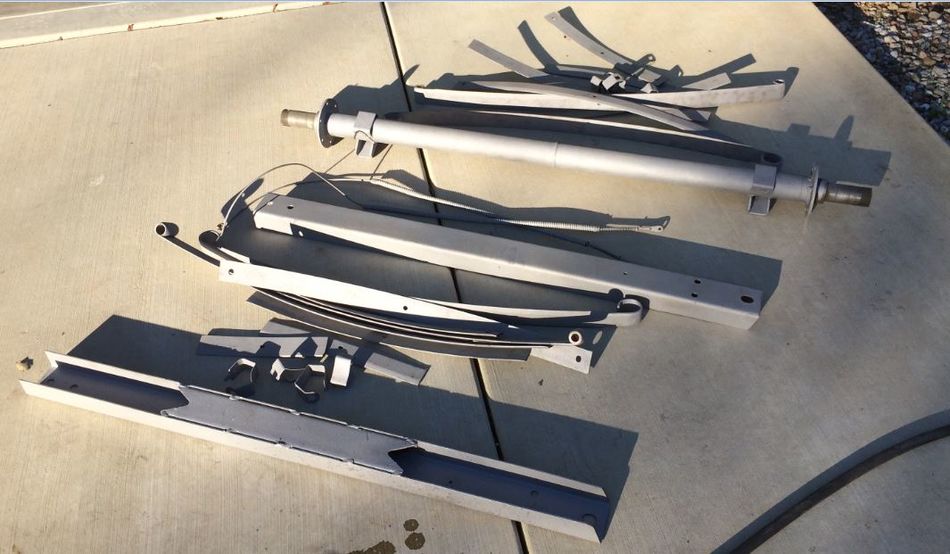

Post by zepher11 » Sun Dec 03, 2017 4:39 pm
Finally had time with the weather decent to blast the last few items for the MBT project. Was hoping to get them primed and painted, but not enough time in the day to do so. Maybe primer and paint next weekend if there isn't any rain:

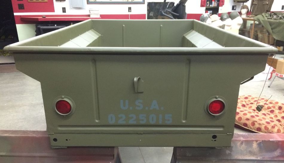

Was going to wait two weeks before applying any stenciling, but couldn't wait any longer. I guess 12 days it will be. I will add the unit numbers to match the markings on my '42 GPW shortly:

That is a thing of beauty! It looks factory fresh, you are a true craftsman.
