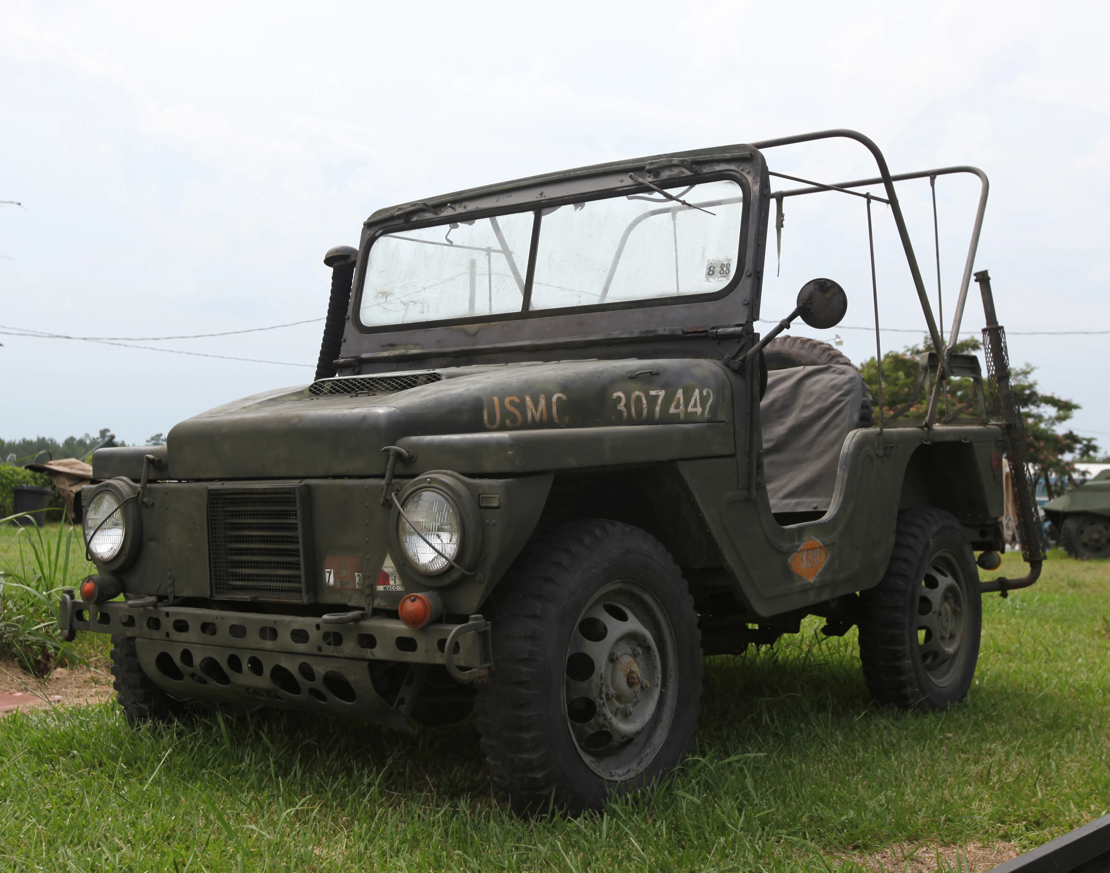

I am installing my doors and side curtains on my M422A1.I have no instructions and I'm having a hard time figuring out how the upper and lower door retainers go.Can anyone help with how these install?It seems the lower retainer is too long,But I really have no idea how this goes together so I am only guessing,And the manual is really no help.Pictures would be great.

This is off google and is way too big to post but it may help you.
http://images.wikia.com/tractors/images ... y_Mite.jpg

Thanks Bill,That does help.I'm a little leery of the kit I have.I'm not sure if it is for the A1.I was told by a Mighty Mite parts supplier that the government did not make winterization kits for the A1.I am dry fitting it before I start drilling holes.Everything appears to fit so far.
