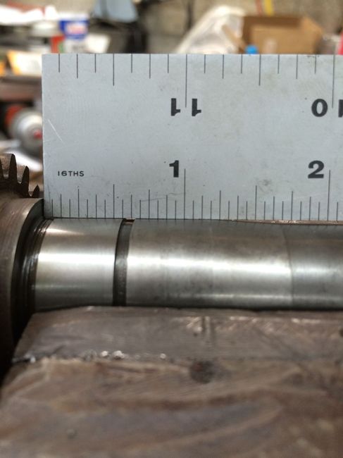

M274
Input Shaft you will notice that the Seal Area stops at 1-3/16 inch then tapers down there is a Seal mark at 27/64 [between 13/16 and 7/8].

M274-A1
Input Shaft you will notice the the Seal Area stops at 1-7/16 inch then tapers down. You can also see where the 2 seals left marks.

M274
M274 Input Shaft

M274-A1
M274-A1 Input shaft
