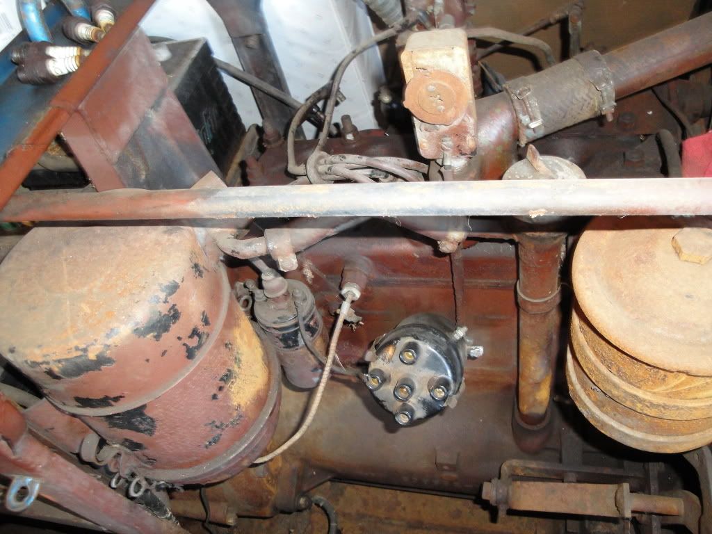

You found a beautiful , pristine unit. I remember seeing those pictures when you got it

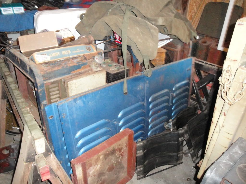

I resotored a 1943 PE-95G to mount back in my 1944 Checker K-52 trailer. I removed everything that could be removed other than the engine block and generator. I cleaned it all up and painted the engine block and generator. I will clean up the skid and paint it when I am ready to set it in the trailer. It did have some wiring modififations that I had to sort out and make the correct connections o get iit to work as it was origionally intended.
Here is how it looked waiting for some TLC
Picture of the top of the engine;
Here is reinstalling and so touch up painting
A dusty control panel;

Upon reflection I would not mess with a unit that is running right. The wiring in the head of the generator is heavy and in some cases the insulation is very easy to damage or loose. I did change the brushes with some NOS ones and repack the end shaft bearing, that is all I did to it. I did not remove the instrument panel or it's housing because again I didn't want to take a chance of damaging the wiring. I did only what I needed to do to get everything back to it's origional condition. Yours is so nice and origional I thing If it were mine, would clean it up , repaint the oil filter and breather, replace the sparkplug wiring and maybe rebuild the carb. You probobly have the nicest origional unit there is and it would be a shame to change it any more that you needed to.
Your Call.
